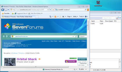

Works on RC1(7100) Just try dragging my dp to the desktop. Maybe its the file type or something.

Got it atlast
if we drag the image anywhere on the taskbar, then it doesn't switches to desktop
but if we drag the image to "Show Desktop" on right side of time then i can !!

You can also 'restore' the active window (Win Key+Down) & drag & drop that way.
