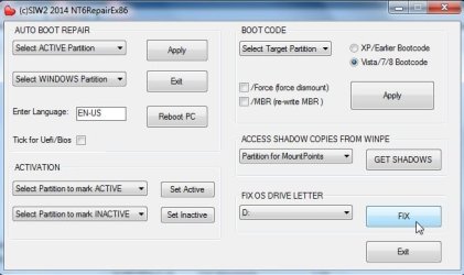

We can fix it.

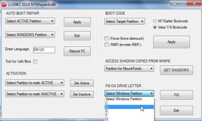

1. Boot into the original installation
2. point this View attachment NT6RepairEx86.zip at the "non genuine" drive. Select the drive letter you see from the os you are currently booted into. From your screenie - looks like you need to select G in the dropdown
3. Click FIX.
( Do not try any of the other functions on that )

When you say boot into the original installation which OS are you referring to? The Currently booted Win_7 installation is on the partition that appears as C: in the seconds screenshot.
Then I see that you are asking me to point the "Fix OS drive letter" to the G: Paritition (which is the new Win7 installation that I would like to use). Then to click fix.

Then I see that you are asking me to point the "Fix OS drive letter" to the G: Paritition (which is the new Windows 7 installation that I would like to use). Then to click fix.
Correct.
will this affect the boot sector (MBR or BCD) on either Disk 0 or Disk 1
No.
Sorry to say, Drive Image missed a step. We are just finishing off what drive image should have done.

No, the drive letters stay the same. It assigns the correct volumevalue to the os drive letter. That is what Drive Image forget to do. It left the os drive letter ( C in your case) still pointing at the volume it used to be on. The letter is just an alias for a very long number, it is easier for humans to deal with.You will find the values in the MountedDevices key in the system hive.

Ok so I did it. Same problem with non genuine windows and unable to run any executables. Do I have to rebuild the bcd or something?

Did it say it completed successfully?
If so, there is something else wrong. Nothing whatsoever to do with bcd store.
If your imaged windows now knows which volume it is on, the other possibility is the image wasn't restored correctly - some bits missing/corrupt.

In fact your solution did work. I was just impatient. It took a long time to login, and during that period it still displayed not genuine in the background.
