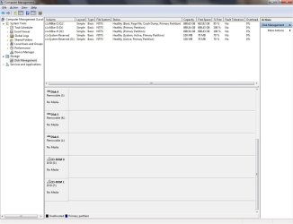

I looked at the disk and DVD drive setup; only two of the drives were online (C: & D:). The 3rd one was offline due to a signature collision. Following is the info from Diskpart inquiry:
Port 0 - D: DiskID: 20000000 (online)
Port 1 - nada DiskID: 20000000 (offline)
Port 2 - C: DiskID: C0923583 (online)
Note that the D drive had never even been formatted. The two DVD drives were (and still are) E & F.
Did some research on this issue & found out how to reassign a disk signature. I used Disk Mgmt & clicked 'Online' for the 3rd drive. I can't remember for certain, but I think there was a confirming entry to put it online - which I did not select at that time (wasn't ready to do this yet).
The next day when back on this issue, I discovered that the 3rd drive was now online as Drive H: (and Port
* 0 *).
After looking at Disk Management, I renamed all 3 disks as follows: Mike-C (C:), Mike-D (D:), Mike-H (H:)
Diskpart inquiry now shows:
Port 0 - H: DiskID: 8D768D76 Mike-H (H:)
Port 1 - D: DiskID: 20000000 Mike-D (D:)
Port 2 - C: DiskID: C0923583 Mike-C (C:)
On top of that, now there is a 'System Reserved' drive (G:) showing up in Explorer. This 'G:' drive is (presumably) the first partition of the Disk 1 'D:' drive. ???? Wow, a 100Mb drive!
Below is the current Disk Mgr screenshot ...
My goal is to first (maybe) try to get this mess cleaned up and re-organized into a sensible structure, and then to upgrade the OS to Win 7 Ultimate *64-bit* - as Drive C on **Port 0** - where the original OS probably was to begin with.

It is perfectly normal for the reserved partition to be 100 MB.
What I see wrong.
You have 2 syatem reserved partitions, both are on the wrong drive.
Partition G should not have a letter.
I would move disk 2 to sata port #1 on the motherboard.
Disconnect drive 0 and 1
Reinstall windows to drive 2 (after it`s moved)
Hook up disk 0 and 1 and delete both partitions on each drive and re format and create 1 partition on each drive.
If you don`t want to reinstall windows, then you must mark C Active and run startup repair to right the system files to C
Right now the system files are on Disk 0, if that disk were disconnected Windows would not boot.

The current 'D' drive (SATA Port 1) has a System Reserve partition on it now (now labelled as Drive G).
A. If I just removed the Drive letter G from this System Reserve partition and then immediately shut the system down, will that System Reserve partition remain intact (and without a drive letter)?
The reason I am homing in on this question is that I recently installed a used reformatted 500Gb Seagate drive in a Dell 755 USFF. During the install of Win 7 Ultimate 64-bit, I split the drive into two partitions. The install went well & I am using that system now.
BUT, when I look at Disk Mgmt on this 755, I do NOT see ANY System Reserve partition on it - nothing but C & D partitions. The C partition status says 'Healthy (System, Boot, Page File, Active, Crash Dump, Primary partition)'. I am wondering why the install disk didn't create a System Reserve partition in the process. ???
B. With the PC powered off, disconnect all three hard drives - remove the power connector from each drive and unplug the interface cables. Is there any particular reason or advantage in unplugging the interface cables from the mobo SATA connectors? Easy enough to do.
Then, physically relocate the (old) D drive to SATA Port 0 and Drive Bay 0. Leave the other two drives powered down and disconnected.
C. Boot the system with the install disk. I haven't decided whether to partition this drive or not - haven't spoken to the owner about that yet.
Given that a System Reserve partition (theoretically) should be there, can I assume the install program will use it? Is there any reason to think that partitioning the disk would have any effect on whether a System Reserve partition would or would not be created, or used if it already exists?
I'll deal with the rest of this mess later.
Pls adv. Thx
Fred
Dell XPS720
Windows 7 Professional x32bit
Intel Core 2 Quad Q6600
Dell OYU822 A00
4Gb
Nvidia GeForce 880GTX
Seagate ST3750640AS 750Gb (3)
750 watt
Tower
Multiple fans
NIS
Ha, I knew you would get lost there, most people do.
A Yes
B Yes
C Running startup repair does not create a Sytem Reserved partition, windows does that when it`s installed, you just want to write the system files to C. The C partition must be marked Active for that to happen. Startup repair may have to be done up to 3 times.
http://www.sevenforums.com/tutorials/681-startup-repair.html
http://www.sevenforums.com/tutorials/105541-startup-repair-run-3-separate-times.html
http://www.sevenforums.com/tutorials/71432-partition-mark-active.html
As I said startup repair does not always work, that is why you leave everything where it is, unplug the other 2 drives (just the power cables for now) and run startup repair. If the drive with windows on it "C" then boots on its own then you can carry out the rest of the plan.
