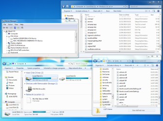

Quick summary of where we are:
"A" (problem)
Dev Man has an "Other Devices" line with the ! icon and ATA - Channel 3
Post #3 said the *.inf, pnf and sys files did not exist on "A" but did on "B" - I didn't copy files across to "A", as I wasn't instructed to
Followed instructions from post #4 - inserted memory stick and got 'driver not installed' message
Don't have a usbstor_inf folder but have usbstor.inf.amd64_folder (screen shot)
Ran sfc - result was "no integrity violations"
USB ports don't seem to work any longer (apart from the 2 connected while running drivecleanup.exe, mouse and keyboard)
"B" (working fine)
Is a virtually identical machine
Also doesn't have usbsto_inf folder.
Post #6 says "Also for usbstor.inf and .sys, right click dev mgr Properties>Driver" - I don't get the "dev mgr" can you clarify?
I do have a system image/restore point.
Thanks!

OK. Sorry for any confusion. my earlier post may not have been clear...
The 3 files i had check you in post #2 if they exist, are part of USB Mass Storage driver. If not there, the USB Mass Storage driver is corrupt. (Mouse/keyboard aren't mass storage devices - so not affected)
So from your snapshot, I want you to open the foldername which starts usbstor.inf_ and is dated 17/02/2013. You should find copies of those 3 files inside that folder. Copy each file to its proper directory.
> The usbstor.inf and .pnf files belong in C:\Windows\inf
> The usbstor.sys file belongs in C:\Windows\system32
Reboot. Try the flash drive again.

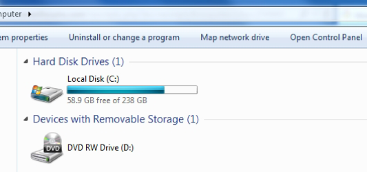

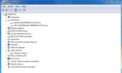

Yes, I can clarify that for you ComputerGeek: in Post #2 I said that the three usbstor files were NOT on the machine that I was having problems with but they WERE on another (almost identical) machine in those folders. Like I said in my last post, I didn't copy them across because I wasn't told to.
I've followed the advice so far to the word, anyway let's move on and I can give you an update.
I copied those three files from the 17/02/13 folder like you said, re-booted and tried the memory stick. Wouldn't install, got no messages.
So I reconnected the old WDC drive, intending to do a restore. I've 2 screen prints, it's installed but I can't seem to access it to do the restore.
Just before Post #3, I had no problems accessing that HDD and it's never given me problems before (other than not having enough storage).
Appreciate any help towards getting the original and new issues resolved - thanks.

So on one machine, we have no USB drivers, and no drivers for a new hard disk; the old hard disk is recognized when installed and booted up.
I agree with ComputerGeek (and thanks for answering my question)...a System Restore would be a good idea, especially since it seems that the Registry's been altered. I might also suspect that SFC /SCANNOW could be run as well to replace missing Windows files... but I don't think that will fix the Registry.
I really hesitate to suggest a Windows Repair Install...
OldLaker... could you install the NEW WD 10EZEX in the other machine, just to confirm that the new drive is recognized by that computer and isn't DOA?

I've provided a screenshot, more so you can reflect on the mystery (if you like) of all this. Those files didn't exist before the hardware upgrade attempt and the machine (with this hardware) runs just fine. The two HDDs (old and new) have been in and out quite frequently, I can assure you that when installing WD2500 (it searched and found the drivers) there is evidently no need for those 3 files. It's odd.
