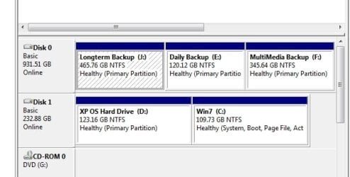

Here's the screenshot. Just wanted to add that this Win7 installation is 32 bit, not 64.

Partition "Longterm Backup" is marked "System" in screenshot. It has the bootmenu and bootmgr. Why do you do that? Is that what you want? If not... what partition do you wanna use for bootmgr and bootmenu?
I don't think I wanted to do that. It's the first disk listed in BIOS. How do I change that? And which partition would be best to use--XP or Win7, or does it matter between the two?

You must have installed to Disk1 with Disk0 still plugged in. The installer will then place the boot files on the first Primary partition so it landed on your backup partition on the preceding disk.
If you are ready to get rid of XP now then you can follow the steps in Recover Partition Space Used by an Older OS with Disk0 unplugged.
Otherwise ater following Kaktussoft's steps to move the Bootmgr to C, I would power down to swap the cables so that Win7 is on Disk0 and future repairs cannot derail the System flag to a preceding disk again. If not then you'll need to change the BIOS boot order to boot Disk1 now.
Then confirm in Disk mgmt that C is System Active. Mark all other Active partitions Inactive.

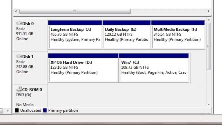

New screenshots. First one is after making partition inactive. Second one is after boot.

It is correct, with Win7 booting itself from within its own Partition (System Active).
Do you need to add XP to a Dual Boot menu now? Install to WIn7 http://neosmart.net/Download/Register/1 to add XP by name and drive letter (or let it autocomplete letter).
Again the risk of having Win7 drive not be first in order is that if you do a reinstall or Startup Repair it can again derail the System flag to the first Primary partition. If you remain aware of that then you can leave it the way it is, just be sure to unplug the first drive if you ever do a Reinstall or Repairs.
If you do swap the drives now be sure that Win7 remains set first to boot, which can be achieved by merely swapping the data cables.
