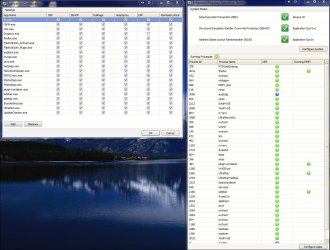

Haven't seen any problems with it since using it, other than having to uncheck EAF (Export Address Table Access Filtering) for Dropbox, as it wouldn't let it run without that unchecked.
Some of the processes I have it configured for atm.

All of the programs I added to the emit list work perfectly, I didn't need to un-check any of the protection options.
On a side note though, I did have to leave hardware dept as 'opt-out' since leaving hardware dept as forced caused my computer lag. Well, opt-out is better than opt-in, at at least now all my apps (cept a few core system processes) use hardware DEP (they didn't before.)

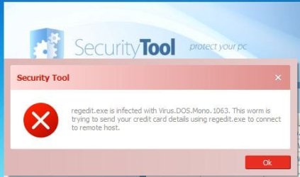

Are you running an anti-malware program called Security Tool or are these pop-ups that suddenly appeared? If these Security Tool notices are pop-ups then Security Tool is probably the malware.
Sony Vaio VPCEB47GM Laptop
Win 7 Pro 64-bit
Intel i5 2.4 Ghz
8GB DDR3
Intel HD 3000
IDT High Definition
15.6 WGXA Anti-Glare LED
1280x800
640Gb 7200rpm

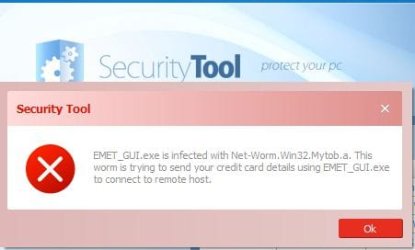

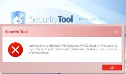

Security Tool is an exe killing rogue security app.
I added Regedit, Task Manager and Notepad to Emet's protection but Security Tool still killed em.
Emet's gui was killed as well.
