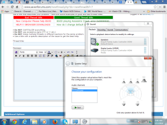

How to get this to play using the minijacks surround sound in wmp and wmc?
VLC does play all the 5.1 channels, center with voices ok..
wmp and wmc only play stereo.
I went thru speaker setup for both wmp and wmc.
