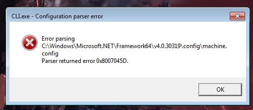

Hello there!
I'm going by memory because I'm not really sure what happened exactly. But...
A few weeks ago I've installed an update for framework, (4...something). I had to restart the computer for updates to apply. However... During the installment, there was a short power outrage. I would assume that the update didn't install itself fully, or properly.
Ever since then, whenever I turn my PC on, I get this error popping on my screen upon Windows start.
Is there any way to fix it? Appreciate the help..

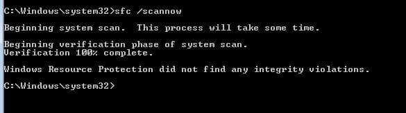

Scanned. Restarted.
Error 0x8007045D still persists.

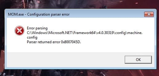

Hi Sierra,
got sidetracked by the error message re NetF - NOT the source mom.exe
i take it your running the ATI Catalyst control centre, mom is one of its processes.
If you dont need it either uninstall it or in Start-up uncheck it.

Hello Roy.
Thank you for another reply.
I do indeed use ATI Catalyst Control Center and I have disabled it in Startup - as suggested by you.
It is still there.
