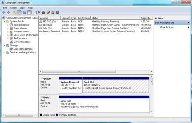

Try removing all partitions from the disk. Mine did this, and after deleting all partitions it made a 100mb "system reserved" partition and the rest to the primary "C" partition.
Indeed, I wiped all partitions, deleted, and formatted, with no avail.
I just attempted install again, I even lowered the partition space to see if that would help but no dice.
I am still getting the same error code and "windows could not install to the selected location/device"
