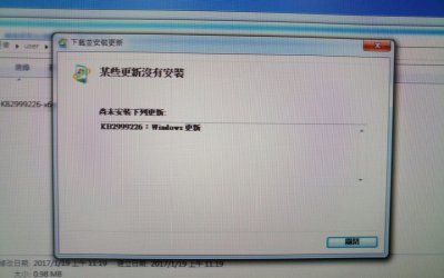

I ran into an Error installing KB2999226 Universal runtime for windows update on Windows 7 Enterprise 64bit with service pack 1 installed. I ran SURT and SFC with no results (though SFC just closed itself when it was finished so I didn't get to see the results myself).

I have also attached the image of the failed update, though it is in Chinese as I am based in Asia at the moment. It does not provide any information about why it failed. It just says that that update failed to install (it was the only one).

Hi Alien,
Its failing on reboot from what i can see, not sure but earlier in the report System Restore also failed, its possible the 2 are related, have you noticed anything.
could you also run this tool, copy/paste the output, might shed some detail on SURT.

Thanks for your reply and suggestion, unfortunately it did not solve my problem. I am considering finding a different way to solve my problem. The portable versions of the software that I need to install require MSVCP140.dll, can I copy this dll file from a windows 7 64bit professional computer and paste it into the windows 7 enterprise computers? Is this safe? Could it work?
The windows 7 Pro computer has the necessary KB2999226 update installed.
