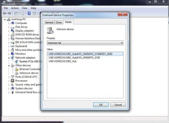

Looks as if the error is from the USB Adapter .... As for the other Device select it right click select Property's /Details Tab ..
Any Information you see there please Post it ...

As in right click the ethernet controller with the yellow exclamation mark? then properties > details?

No the other Device listed below that ...

Its a Asmedia XHCI controller , dont think its related?

Remove your USB device then Uninstall the ethernet controller with the yellow exclamation mark and Reboot your Computer ...

What about the USB Adapter is it unplugged ? ... If so proceed with the Uninstall ...

That looks as if it is the USB Adapter that is showing with the yellow exclamation mark so Uninstall it ... Your Lan connection looks as if it is working .... Having both Installed at once would make the On-board one disabled ...

I've already tried uninstalling multiple times , whenever i click scan for any hardware changes the ethernet controller with yellow exclamation mark will pop up again. Tried uninstalling and rebooting too , same stuff happens.
