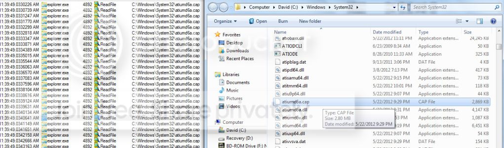

I ive had this computer for about a week and already im running into this problem with explorer.exe. like the title says explorer is taking up most of my cpu.
when i use process monitor i says its reading a file called atiumd6a.cap and process monitor is riddled with it. so i was wonding if you guys could help me solve this problem.

HiJack This won't help you much since this isn't any malware but an ATI driver issue for some reason pointed at with the ATI atiumd6a.cab not cap file. You are likely running into a display problem as well as seeing several system files missing or being reported as missing.
The first thing you can try right off would be a run of the System File Checker tool with the "sfc /scannow" command typed in...? Well if you can find the Run command line option right click in the corner where the Start screen pops up or open a command prompt.
For Windows 7 since you have 8 listed as your OS the Start>Run is right there for that. The WMP file missing as well as the others may be from an initial bad install of Windows unless the files pointed to are found to be present and only misreported by HJT.

That was cap not cab! My goof when finding the same file in the System32 folder. Reinstalling the same Catalyst version should clear that one up for you as far as the display file.
