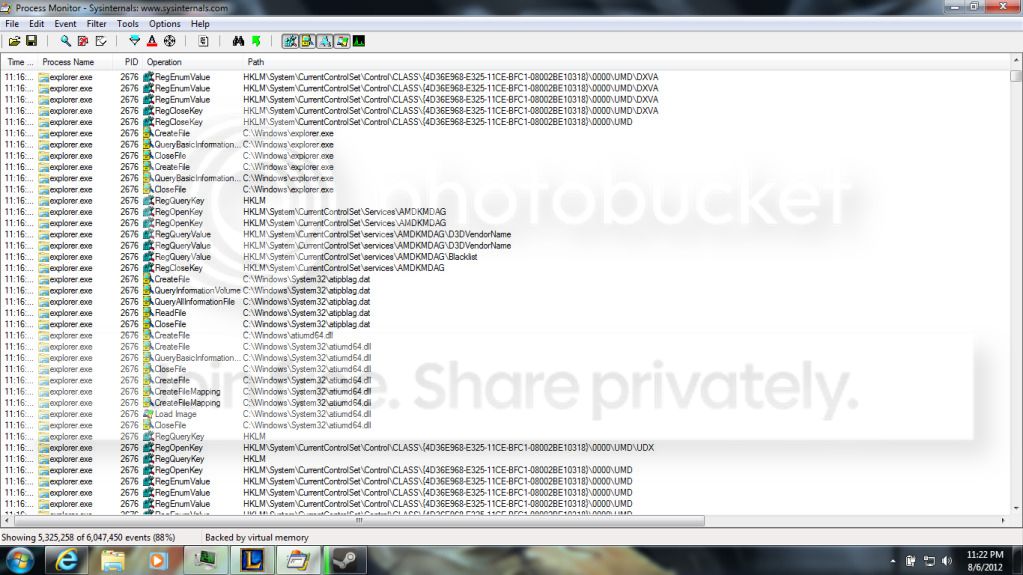

Ok got the laptop replaced becuase of a keyboard issue. ANyeays the problem is back and its worse, It is although triggered by League of legends
it does the reading of the atiumd.cap
then it does a regEnumValue HKLM\System\CurrentControlSet\Control\CLASS\{4D36E968-E325-11CE-BFC1-08002BE10318}\0000\UMD
then it does the same regenumValue HKLM\System\CurrentControlSet\Control\CLASS\{4D36E968-E325-11CE-BFC1-08002BE10318}\0000\UMD\DXVA
Then well see for yourself
Also when i boot up the computer i get you amd driver is not installed or is not functioning properply please install a driver for you AMD hardware. I looked on device managedr and it says its working properly ive heard that when you uninstall a driver AMD is known for not cleaning up is there any program i can use to make sur ethe uinstall is "clean"

If you were on a desktop with a separate expansion card I would advise going into the ATI folder and look in the sub folders for the uninstaticat.exe type file which would remove the registry entries as well as the main drivers.
There however I would say you might have to use a driver cleaner once the drivers and Catalyst if present are removed. Or going into the Device Manager>Display adapter to right click and check off the delete drivers box once the Catalyst part is first uninstalled.
Once the drivers and Catalyst are gone you then go back into the registry to track down those two entries only to manually delete both if found. That will take care of any duplication errors which seems to be why you are seeing the Cat. drivers missing or not responding type messages despite the drivers being present and active.
You could simply remove one of the two entries now but which of the two? This is why the uninstall first and then manual edit would be advised as well as creating a restore point manually right before this is tried. If all goes well when seeing the reinstall afterwards with a fresh driver set make a few more good restore points.
