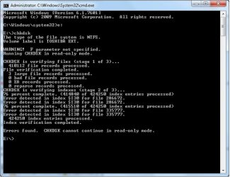

I am trying to fix a new Toshiba Canvio 3.0 1.5TB drive that has errors. Each time I plug it in, I'm directed to run CHKDSK, but CHKDSK fails to complete with the /f parameter. The process stalls at 76%. If I run CHKDSK without the /f parameter, I get the following result:
Again, if I run CHKDSK /f, the process stalls at 76% and hangs forever. I've left the process to run overnight with no progress.

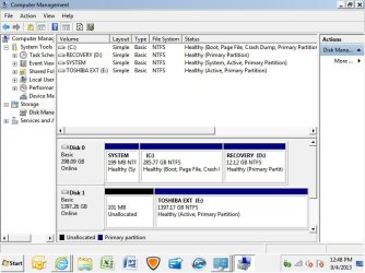

Jumanji; Here is a screen shot of Windows Disk Manager:
Disk 1 shows "Healthy". Any other thoughts before I start to save my data to other devices? Thanks.

The drive is marked as Active which means Windows thinks there's boot files on the drive. Windows will place handles to the drive to suppress certain activities. You might try running CHKDSK with the /x parameter instead of /f. This performs the same function but breaks any handles to the drive first.

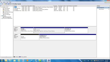

I downloaded Partition Wizard (neat little tool) and set the drive as inactive:
Then I ran chkdsk /x. Same results; freeze up at 76%. I ended up running chkdsk via both the command prompt (with the /x) and through Properties>Tools on my E drive. I noticed that each time I run chkdsk, the number of index entries processed gets a little higher. The history is: 415298 index entries processed, 415338, 415347, 415352, 415392. Does this mean anything?

What I mean is; did you stop chkdsk? I would expect it to run for a couple of hours on a 1.5TB drive.
After you marked drive E: Inactive, did you mark C: as Active and reboot? Repost an image of your Disk Manager as it stands right now. Then don't touch anything else. :)
