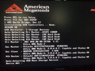

hi everyone, i had a century external USB handisk case with 160gb seagate sata hardisk connected with my PC, this ex. hardisk work fine when i connected to windows, it can be detected, read and write, everything just fine, but if i turn on my PC while i'm connecting with the ex. hardisk, the PC freeze on the below screen, this matter only appear when the ex.hardisk connected to PC and turn on, if i unplug the seagate hardisk and just connect with the century external USB hardisk case, the computer will turn on finely without and freeze of screen, the only thing i can do is to unplug the hardisk first for the turning on the PC, then plug the hardisk back when it the windows totally start up, can anyone tell me why would this happened? and are there anyway to solve this problem so i don't have to unplug and plug the hardisk every time i start my PC? thx alot~
P.S. i'm using windows 7, and my MB is MAGIC PRO MP-AKX Extreme, as i remember, this only happened on windows 7, cause there is no problem when i was using XP...

thx, i have just try your advise, but the freeze screen still happen...:cry:

if it's freezing at the post screen like that it suggests that it's not related to the OS but rather a hardware issue

Screenshot
so the screenshot is the exact place it freezes just to be sure here

Screenshot
can you post a screenshot with what you have hooked up now

Bios setting
In the bios, choose to not use/recognize legacy USB devices that should solve your problem
thx! this one work! but can you tell me what is legacy USB and what it would effect if this turn off? thx alot!!

Legacy USB
this is for older USB 1.0 devices from long ago we now use USB 2.0 for everything it transfers data faster

Problem Solved
I am glad this solved your problem don't forget to rep! thanks
