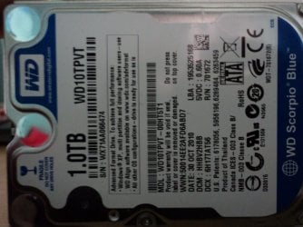

no i did not can you please provide a link? Its a western Digital Scorpio Blue

no cant find my drive there wich one is it see picture

Is this drive in an enclosure? How are you connecting it to the PC? If its not in an enclosure you will also have to supply power to the drive somehow. That picture looks like an ordinary hard drive that would be mounted and connected internally.

yes it is in an enclosure
