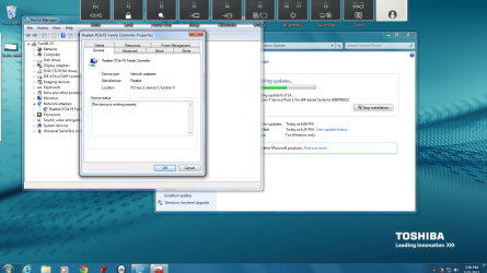

I took screen shots of what I think you are talking about....My apologies i am not that tech savvy.

No wireless driver in device manager. No missing drivers and other problems as well in device manager. It's just not needed now. Wireless adapter has hardware errors or you did disable it.
I see F6,F7,F9 etc on top of screenshot. Where is F8???
Try pressing FN+F8
Press FN+F6 a few times. Screen becomes darker? Press FN+F7 to make it brighter. Does that work?

Yes when I press "FN+F6/FN" it goes dark and light. But when I press "FN+F8" it does nothing and as you can see it doesn't come up. I was told it could be the wireless in my laptop could be bad. OR just get a USB wireless adapter.
