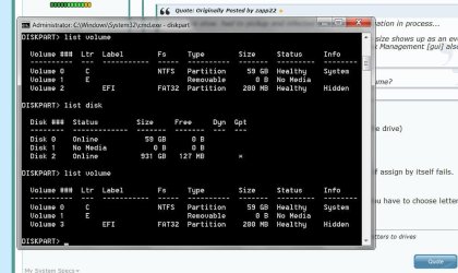

gang I've gone OCD+ now... over the holidays I had some more time to put in on this project. That drive is 'failed' in such a way that its not only difficult to detect/read or run tools on, it actually crashed two different system. it left one of my Vista mules in such a condition that it went out of Activation... and that was merely by slaving it across USB. Disk Management would hang/crash, destabilize the system... twice it blue-screened on me. Crashed a Win xp system in similar fashion but no damage.
The several times I was able to run either chkdsk /r or chkdsk /f, it typically would run for 20 hours or so, hit about 9% to 17% complete, then flame out. so gave up on that approach.
went to a third system, my "go to" win7 Ultimate lab do-anything sys, hooked in by usb adapter. after trying different jumper settings [which, I thought would make no diff using usb adapter, but it apparently does make a diff]. .. sometimes windows could not detect it - game over. power off, change jumper, back up. - could detect, but could not online it... "device not ready".
Anyway, when I finally got it stable enough to Letter, I tried running Photorec and Recuva. For reasons I don't understand, photorec would go AWOL at the stage of drilling down on the volume - that is, merely identifying the volume, then hitting "Continue" it would just sit for hours without moving to the next screen, so I gave it up. Recuva could not open the volume - bailed immediately.
So I finally took the final, possibly fatal step of formatting [the drive would alternately, depending on the tool, show a FAT file system, NTFS, and/or RAW]. I tried twice unsuccessfully to 'quick format' ntfs. 3rd time was the charm - it succeeded. After that, I ran Recuva quick pass for one filetype and reclaimed 2 .pdf files that I could pull up and read. That was encouraging, so it is now in 'deep scan' mode, ran for almost 20 hours and is at 1% complete. So I'm going to stick with it as long as that complete %-age increments.
