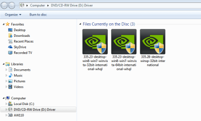

Is there a utility to expose the flaw or the fraud? It came with a driver disk, but I think it is also a fake somehow as the card does not work properly as a GT630 should.

There is a driver disc that will install an old driver. But it is not upgradeable from Nvidia. Install an upgraded driver and it fails.

Something is not right about this card. The driver disk has 'international' in the driver directory.

I searched for that driver and I found this and it shows international driver
nVidia graphics drivers v341.44 (8×)
'File name 341.44-desktop-win8-win7-winvista-32bit-international-whql.exe'
I should try to download and install and see if it works. well they dont download.
