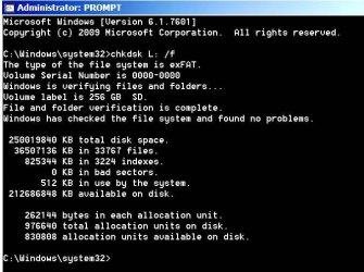

Thanks for the help. I ran chkdsk as admin on the 256 SD & laptop C: SSD drive. Below are the results:
Checking the C drive re-booted but did not show results like the L SD drive.
Looks like the results show both drives seem to be OK. FYI: Both my PCs have SSD drives about 4-5 yr old.

You can use check disk just to check it, without fixing any problems (chkdsk c:). The /f (chkdsk c: /f) is to fix the problems it encounter. Under Windows, as the disk is in use, it cant be done. That is why it must be done on a startup.
On the check disk log, look for bad clusters and/or bad blocks.

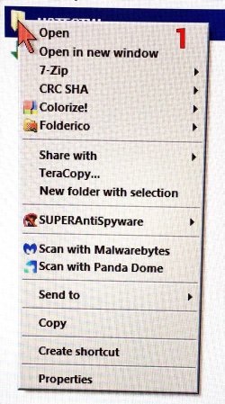

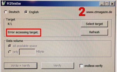

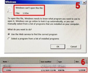

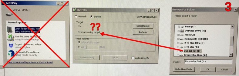

The following images, 1 thru 6 represent the results I recd when I initiated H2testw to test the Samsung 256 mg micro SD formatted in ex FAT. (The drive was clean as per instructions I formatted as ex FAT.)
NOTE: somehow the forum uploaded images 2&3 out of order?
Sorry if I seem discombobulated as I'm not seeing what I expect to see & you have been patient and I don't want to waste your time.
Thanks & Regards,
klxdrt:cry:

The file 1.h2, 2.h2......500.h2 are the files h2testw.exe create to test the drive. After the test you can delete all them
