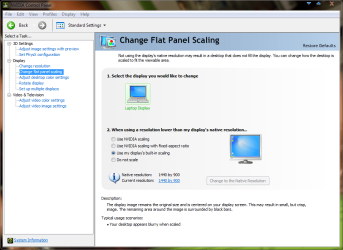

If you can please put the picture or put a small explanation how to enable this option it would be great !
it will help many people!

Open the Nvidia control panel by one of 2 methods. See pic for settings.
1. right click desktop then left click "Nvidia control panel"
Or
2. left click on "Nvidia control panel" icon in your computers control panel

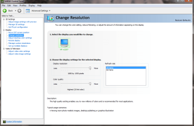

I dont have this option , Look :(
After you told me about this option I installed 3 different version of drivers none of them had this option .
It seems the drivers think you have a CRT monitor, i would suggest installing any drivers you might have for that monitor or cleaning out all the old video drivers from your system and install again.
