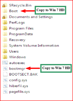

In order to do this Win7 needs to be marked Active first from the booted installer's Repair console Command Line: http://www.sevenforums.com/tutorials/71432-partition-mark-active.html

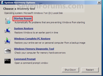

Run Startup Repair up to 3 times until it starts, then watch what happens with the drivers.

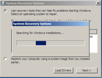

When you boot into the installer, on the second screen there is a "Repair My Computer" link. Is this what you are clicking to get into the Repair console? Is it finding any installation to repair?

Do copy & paste both of those boot files?

When I click repair button on startup window in seven setup, it begins searching errors and finds an error in bootmgr and asks me if I want to repair it. When hitting yes, it shows me then the next errors : Unable to backup startup options. And : The system reboot cannot repair automatically this computer.
Os box is empty.
Nope !! Will try tomorrow when my friend will be awake, thanks !

So you click through to Recovery Tools list to run Startup Repair here?

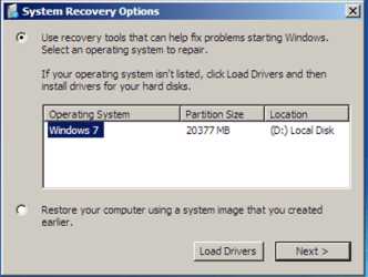

Yes I see all these except I don't have any OS shown in the "System recovery Options" box. I assume also I have already switched HD as Active in windows administrative tools, just checked : Online, Healthy, Active.

Now see if Repair console discovers an installation to repair and run Startup Repair x3 if necessary.
If it will not discover the installation then it is damaged or irreparable in most cases.
