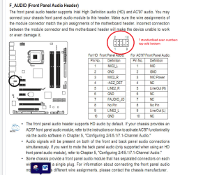

Yes Spy sorry mate I should have been a little more explicit. The pin arrangements are different for AC97 and HD as you can see in this snip I took in another forum.
This may not be the config of your board (but probably is) but you will get my drift as to the small metal "insert" in the plug being dislodged and therefore not making contact.
The only thing I don't know is how the pins are numbered for your board socket but again probably the same is the pic as most boards I think are probably as standardised to that config of pins.
Some new boards may have this socket along the side where the USB sockets are

I did not touch anything inside the board, this just happened from one moment to another, if i let the plug touch a lil bit the jack, it will play, but if i fully insert it, it wont. in AC97 mode i have not this problem, i can fully insert the jach in the plug and it will work.. Everything seems normal inside.
And all of sudden i got a plugged subwoofer, when i dont even one. it shows on the image, the orange jack. So weird. geexz.

Smacks of a loose pin in the board Spy - sometimes caused a by "dry joint" - one the solder has become unsoldered from the printed circuit on the board - or the pin pushes down still attached to the circuit strip and will not fully engage in the HD plug.
If you can just very gently and with a non conducting probe try the pins in the socket to see it one of them moves down. It not necessarily be the "live" one but the ground pin that services it.
If they are all fairly solid to the touch then it may be worth having another look at the HD plug but I ma thinking the board socket pins.
