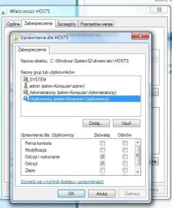

I mean right click the hosts file - properties - security
In that page admins and System should be Full Control and Users Read + read & Execute

system, admin, internal administartor = full control
users read & execute
i have this:

They seem to be alright.
