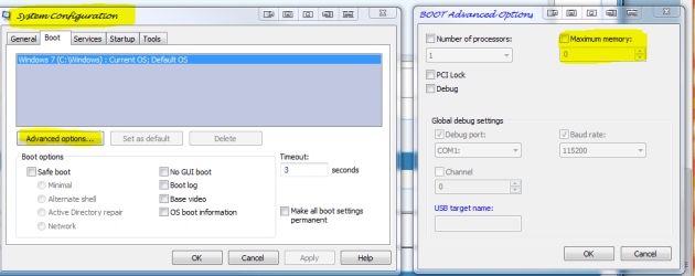

have you tried this press windows key + r type msconfig > press enter > go to boot tab and click > then click advanced options > in the boot advanced options pop up make sure the maximum memory is un checked (no tick in box) > press ok and reboot if a pop up tells you to:) *see png at foot of page*

Unfortunately the box was already unchecked and I can not find a memory remapping option OR an AGP video aperture changing option. Does anyone know if my motherboard is compatible with either of these or a way I can find out? Any other suggestions?
