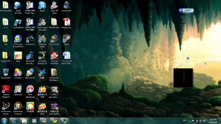

i faced difficulties about my desktop gadget, see the attach picture,
anyone can help me step by step? i will appreciate ur kindness help.........

Picture is not very helpful. can you tell us if sidebar.exe is running in task manager?
(task mananger= right click task bar.........)

to docbrown: any gadget ,
to ken: yes, it runs in the task manager
both any suggestions?

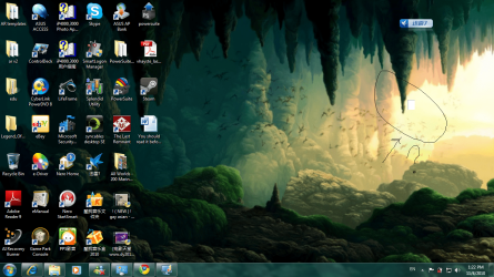

i had upload new problem picture,kindly have a look

to docbrown: that one i tried oledi,,also cannot work
