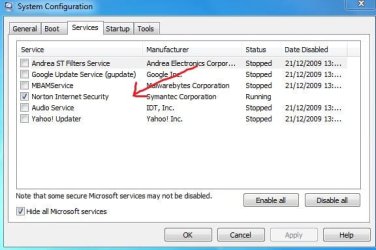

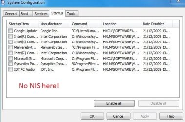

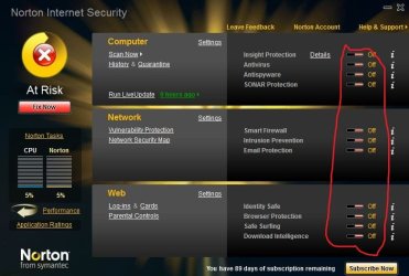

I tried to do as you said.
But I can't disable it.
I logged in as Adminstrator account and opened msconfig, on startup there is no NIS (see pic)
I found NIS on services, but when I disable it (or even press disable all) and press apply, it auto enables itself.
I think it is self protection.
So I turned off all settings from NIS (see pic), and tried it. Still it auto enables itself.
I tried to boot in safe mode and disable it, but again it auto enables itself :shock:
What to do now?
Thank you.

Open NIS - Miscellaneous settings - Turn off tamper protection and then try disabling the service.
In safe mode, only MS services run. NIS doesnt run in there. So, check in safe mode whether your gadgets work.
