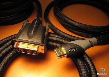

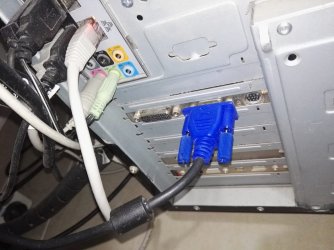

attached are pics of the cable and the outputs..
any idea?

Not sure about the cable but have you tested the vga port on the card with your monitor ?

On a more helpful note, maybe that DVI port is the wrong kind? Memory fails me, but what if it is a DVI-I when it needs to be a DVI-D, or vice versa. I can't remember which one can drive HDMI, but I'll look it up...
EDIT:
I can't tell from the Nvidia specs, but I believe that the card is a single link DVI-I connector. The OP might need a dual link output to "see" the TV. That's what I was getting at above. The cable looks right in that it is dual link, but the card may not be.
That's all I got. :)

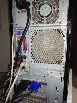

Do you have a hdmi port on the mother board ?
Does it have onboard graphic's as well you only show the card and not the entire back of the computers connections :(

here is another pic..
no i dont have hdmi port.. its an old pc..
i really think that the DVI-HDMI converter is probably not working well.. :confused:
i guess i need to order a new one..

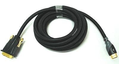

I was talking about a new converter.. Not a new gpu..
