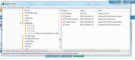

Hi levelbest,
follow the instructions below, then can you copy/paste yours
  1. type >> regedit << in the Search box, and then press ENTER.
  2. In Registry Editor, navigate to HKEY_LOCAL_MACHINE\SOFTWARE\Microsoft\Windows NT\CurrentVersion\ProfileList\(expand it)
yours should be like mine.
Roy

Hello Roy
I've put the registry screenshot below. It seems look like yours.

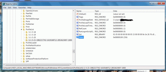

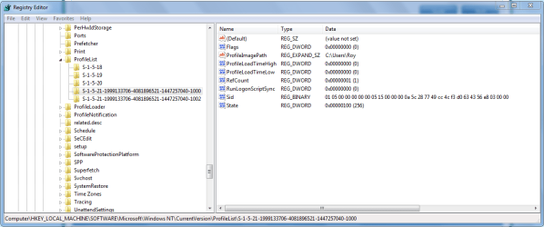

Hi LB,
in the 1 5 21 section what are the last 4 digits 1000 or 1002
1000 is the admin 1002 is a user, ill post the right hand side block details of BOTH
compare and change as required.
Roy

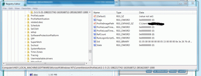

Hi Roy
I hope this is the info you need.......

Hi LevelBest,
please amend the values for
refcount to 1
state 100 (256)
the same as mine
Roy

Hi Roy
Can I double check what you mean? I’ve not ever entered into registry territory and am a little nervous.
The line on yours that states Ref Count which ends with 01 (1) and on mine ends with an 08 (8) – do I change both the long figure that ends with 08 and the bracketed (08)? Or does changing the long number automatically update the number in brackets?
Secondly, on yours on the state line which ends with 100 (256) and mine says 000 (0), you want me to change those numbers?
Thirdly, can I reverse this via a restore point if something goes wrong or would I need to go back into the registry and manually change it?

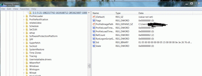

Hello Roy
I've gone ahead and changed the registry entries.
The first gif shows the new registry numbers altered to the new value. I immediately re-booted the machine but when I went back to check, the entries had changed, the Refcount showing 2 and State had gone back to 00000. Is this normal? Or should the values stay to what I changed them to?

Hi LevelBest,
NO they should not change back.

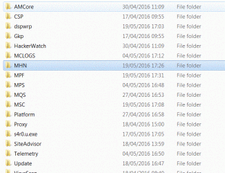

Not intruding Torchwood, your advice is exactly what I would have given, but just a note for LevelBest: -
Malwarebytes was designed NOT to cause conflicts with any other AV product. For example: I run Kasperky Total Security and Hitman Pro, with Malwarebytes Pro and have no conflicts whatsoever. I also ran Bitdfender in the past for 3 years with Malwarebytes Pro and never had a conflict. So I am almost certain that your problem is not a conflict between AV/anti Malware programmes, unless McAfee does cause conflicts.
EDIT: I found this: https://tinyurl.com/gr6vkcj
You will have to delve into the Malwarebytes Exclusion folder and add 3 files as shown by the link. If there are conflicts, this will prevent them. Were I you, at McAfee upgrade time, I would drop it and buy a better AV product. Just my poinion, I do not like McAfee or Norton.

I came home a little early from work, so am getting started on Roy's list.
The reason I uninstalled Malwarebytes was because I thought that was causing the PSO problem. However, I'm still getting it, so I was intending to reinstall at some point, so this has given me the opportunity to do that. Thank you, Layback Bear, I found the rootkit option. I've performed a MB scan without the rootkit option ticked and I am re-running again with the rootkit option ticked.
I'm going to need some guidance with delving into the McAfee logs. I've located them in the C drive programmes but there is a large list of folders (gif attached) and I don't know which one/s I should be looking at. I'll await Roy's guidance on that one.
I'll also await Roy's response or whether it's an idea to change the registry permission settings.

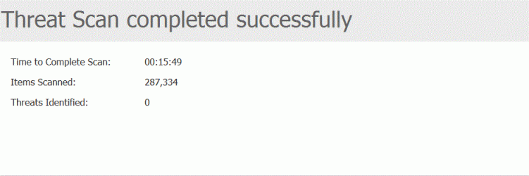

Hi Roy
As above post, I've done two scans with MB, the second one with the root kit option ticked. No issues.
Could you please help with what McAfee logs to look at.
I'll leave the scan with ESET to another time (bit nervous about disabling McAfee!)
