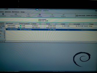

Okay so this is what Gparted found.
Could you tell me if there's any thing wrong and how to get rid of it?

Do not see any partition in GParted with Flags: boot, hidden
Don't think there is a RootKit...
If you post the TDSSKiller report, as previously requested, and the Farbar Recovery Scan Tool, that will provide some enlightenment as to whether the problem is malware.
