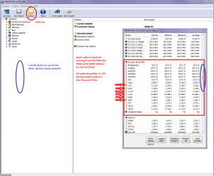

Ok before we go ahead with the Kaspersky rescue disk see this and let us know the results
Using HW Info
PART A:
You can test the volts on the PSU with HW Info HWiNFO, HWiNFO32/64 - Download < download the right bit version and close the right hand window select Sensors and scroll down to the power section where you will see what the volts are doing see my pic. In my pic the section (Nuvoton) with VBATT as a dead give away you are in the section for the rail voltages. There are other section titles and one that pops up often is ITE (sometimes the usual one for Gigabyte boards)
Now the voltage on the different rails have to be within 5% =+/- of what is required or the machine will not work properly if at all.
Limits +/-
12v = 11.4 – 12.6v
5v = 4.74 – 5.25v
3.3v = 3.135 – 3.465v
The Power good signal voltage at pin 8 on the 24 pin plug (grey cable) should be the same as the 5v rail reading/s
See this for the rail voltage info
PSUs 101: A Detailed Look Into Power Supplies (Section 2.)
The original right hand window shows the machine running and is handy for that but for looking at the components in some detail close it and use the main left hand side panel
FOR OTHER COMPONENTS
PART B:
Open each small square with + in it on the section the components are in and then click on the individual component/s (it will highlight in blue) - in the right hand side will appear all sorts of details including brands speeds and other essential info that particular device. See pic for example.
Now you may think the PSU has nothing to od with anything but it is very often missed as a cause of problems it doesn't take long to do and I would like to see what the rail volts are for your PSU see the pic of my Ivy (Asus board ) build for an idea of what you are looking for.

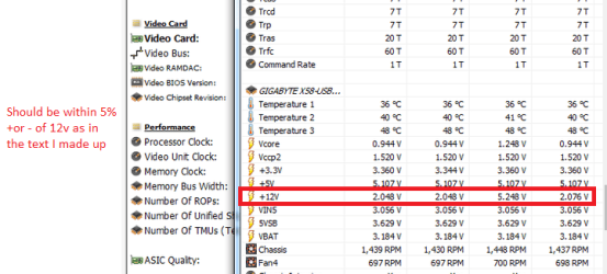

Here are the results. From what i understood i think this is what i am supposed to look at. Is it normal for the +12V to be 2.0-- ?

Ok mate looking at the rail volts you can see the 12v rail is so out of whack and is probably the worst I have ever seen - see pic.
Now the only way to confirm that fault is to measure it witha digital multimeter black lead to any black on the 24 pin plug and the red lead to any yellow on that same plug. Don't use one of the old analogue meters though they inject typically 9v into a circuit to test. If that reading comes back the same the PSU is no good.
See this https://en.wikipedia.org/wiki/Power_supply_unit_(computer) < scroll down that page and you will come to a large diagram of where to find the rails on the 24 pin plug
