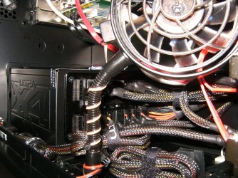

madcrate, that cooler isn't sucking out the hot air next to the video card, noticed solid bracket in the picture, I'd avoid just pushing air around, if they have a slot to put a fan in, I'm for sucking out the hot air, I think OP likely doesn't even have a problem, yet. [prevention is wise though!]

10-4, getting hot air out is paramount. The OP should be fine if he has adequate air movement inside the case.
Sometimes you just have to use a finger to confirm the software reported temp:cry: yep, it's hot.
