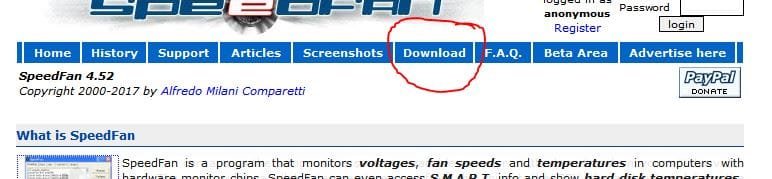

Also, don't just click any download link on the Speedfan page. You have to go to the "Download" link on the top of the page here:
And go to the Download section and click on "Speedfan XX.XX (version #)"
I've noticed a few times when upgrading Speedfan that there are various links on the first page which are old versions of Speedfan and they are bundled with reported PUPs and possible malware. These links should be avoided at all costs.Checking the product page, it seems that they have been removed for now, but I'm sure they will return.
