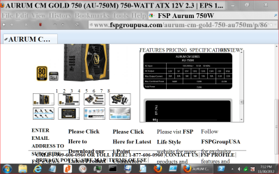

I would suggest looking into the power requirements of your GTX 460.
EVGA | Products | EVGA GeForce GTX 680 | 02G-P4-2680-KR
I requires a two 6 pin power supply connections.
A 12+ volt rail at 38 amps. Your power supply has four 12+ volt rails at 18 amps each. Your power supply has more than the required watts but is under amped for your video card. This may or may not solve you problem you are having now but you do need a proper power supply if you want that card to work proper.

I strongly doubt it's a PSU issue. I have no problem playing games for hours on end. This is a problem that occurs when I go to sleep, leave the system idle, and wake up to find my monitor is stuck in power saving mode. I strongly suspect it is because nVidia control panel is enabling 3D. I found the "Enable 3D Vision" shortcut in my list of recently executed applications.
