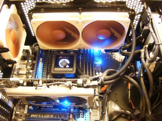

Can I see a picture of what you are up against? I have 4 fan p/p set up to the top of my case and I'll have a better idea with a picture of the case and what your facing. Are you going to run the two stock or additional fans and is it intake or exhausting through the top?
