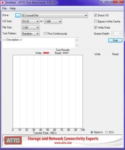

I have a lot of those HDD speed testing tools, but out of all of them I like ATTO the best. Simply because of your ability to chose the parameters to get more of a better idea on real drive speed.
My copy might be very old, but here are my settings. If you go above 1 MB for the I/O it'll take forever, and 1 MB should be good enough. Beyond that you'll probably start to see comparable results for 2 MB, 4 MB, 8 MB, and so on down the result list. I chose not to bypass the write cache since by default, all hard drives in Windows will use it anyway and that'll most likely be your default configuration. Disabling it should give you a poorer speed result. But it will give you a more exact result. It's just that you more than likely won't use a hard drive with the write cache off anyway. So bypassing the cache in ATTO and reading the result is superfluous.
I will try to use ATTO. I am glad that you have share your settings, which makes me clear in my mind as to how one should use this tool. Thanks.

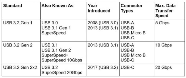

They have confused things by redefining USB specifications as new ones were released. For example, USB 3.0, USB 3.1 Gen 1, and USB 3.2 Gen 1 are just different names for the same thing.
USB: Port Types and Speeds Compared
USB: Port Types and Speeds Compared | Tripp Lite- -
