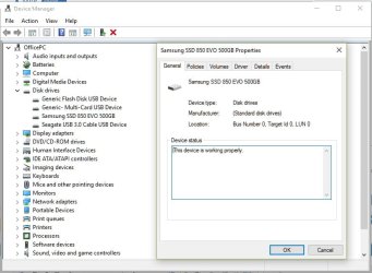

Windows 10 Powers off SSD instead of going to sleep
I know this is an old thread, but I hope someone that has posted previously or one of the moderators will see this and can help:
About a 1-1/2 months ago my 1GB HDD failed, along with my motherboard (due to chassis mount screws that had not been tightened at all during a warranty repair :mad:). I decided to go with a SSD and upgraded RAM from 4GB to 8GB using (2) Crucial Ballistix 4GB sticks, and upgraded from the onboard graphics to an MSI Radeon R7 240 2gb graphics card. Reinstalled Windows 8 and upgraded to Windows 10. I have been blown away with the startup/restart speeds and pretty much everything else: even programs like Excel and Powerpoint open in a blink of an eye, and the machine just couldn't run much better, except...
About a month in, the HDD has been turning off instead of going to sleep as it was set up to do. I've gone through all the power option menus, and have also gone to "Power Options >>> Advanced Settings" to make sure that the "turn off hard disk after ___ minutes" setting is set to "never" (0 minutes). (See Attached Screenshot) The computer still shuts down completely (and reliably :o) after 30 minutes every time it's left idle. Aside from a log-on screen that doesn't display properly when the computer restarts (or wakes), this thing runs great!
Can anyone point me in the right direction?

Hello Paul, and welcome to Seven Forums. :)
Does Windows 7 see the SSD as a SSD in Device Manager?
The "turn off hard disk after" setting only applies to a HDD, and is not suppose to affect a SSD.

Yes, my Windows 10 device manager sees the SSD as a SSD. Is there any reason I can't get it to never turn off? It wasn't doing so until about a month after I'd installed it and reinstalled the OS.
Thoughts?
Thanks - Paul

Just to clarify, what is the SSD doing to make you believe it was turned off?
Are you sure that you're not waiting on any other connected HDD to turn back on (spin up) instead?
