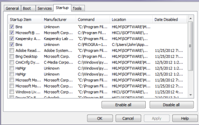

Hello and welcome mostly I reckon you should look at what is being used at boot up > Start > type msconfig > right click run as admin and go to the tab Start you will see what is being loaded at boot up you can then work through some of the bloatware which sounds like lot of your problem too and untick them see my on boot pic.
Another helpful thing is this Autoruns for Windows to see what you have running and this for a bit of tuning up-
http://www.sevenforums.com/tutorials/11728-optimize-windows-7-a.html?filter[2]=Performance Maintenance

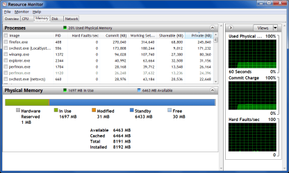

Here's my RM.

No, you don`t have but 1 MB towards hardware reserved, your good to go. That`s how my XFX board shows with 8 GBs, almost all free.
