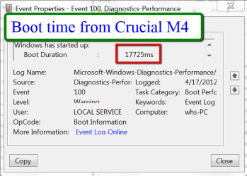

These are very good numbers. None of my numbers are that good but as long as boot is faster than the time the system is sitting on the BIOS splash screen, I am happy.
On this system here I boot in 17.7sec (event 100 in event viewer) from a single Crucial M4. But most of my systems I am running from an external SSD under VMware Player (Windows 8 and six Linux distros). There the boot time is slower - already because of the VMware overhead. But Windows 8 still manages in 30 seconds and most Linux are faster (except Zorin).

your boot time does not include POST...my times do, stop watched on my phone from pressing power button too desktop appearing after logging in, you could probably add anywhere from 4-10 seconds on to your time depending on your POST
from window loading message appearing to desktop appearing is 6 seconds
how do I find that number you have in EV? - wouldnt mind seeing what mine says (when I put the RAID back in)

For the EV time, drill down this chain:
Eventvwr
Applications and Service Logs
Microsoft
Windows
Diagnostics - performance
Operational
Event ID 100

I go by what's in Event 100. That always gives me an apples to apples comparison. With Linux, I do the stopwatch method too because they do not record the boot time - at least I have not yet found it.
