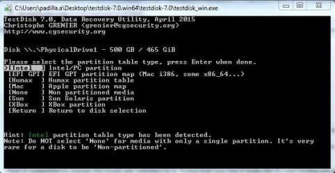

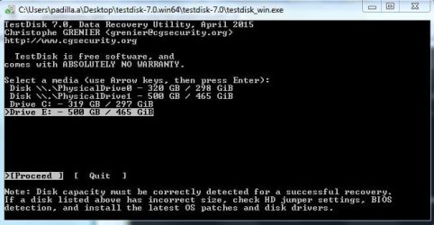

I have downloaded TestDisk and before repairing the partition I want to use TestDisk to take a look at the files and do a test by recovering one random video. Following the steps in this thread I encounter that When Selecting the Drive (the last line of TestDisk), TestDisk identifies that there is no partition table type in my drive. But when I select the HDD in the second line of TestDisk, it identifies a Intel/PC partition table type. I am attaching 3 captures of TestDisk to illustrate this:
  • Disk and Drive as shown in TestDisk.
  • Drive None partition table type detected.
  • Disk Intel/PC partition table type detected.

  1. Is it ok to use TestDisk to solve this problem? I think the problem is the HDD partition got corrupted when I disconnected it.
  2. If yes, should I select Disk or Drive in TestDisk?
  3. Then, should I follow the identified partition table type?
I think choosing Disk (the second line in TestDisk) and then choosing Intel/PC as identified is the way to go but I am not sure nor confident so I prefer to ask the ones who know, you :).

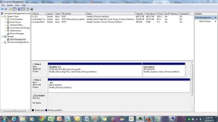

3. Screenshot of Windows Disk Management: (Image to illustrate this)
I would really appreciate your help. I have learned a lot already reading this thread and others in this forum but I am not totally confident in trying to repair the partition or copying the any file from the HDD by using TestDisk (or any other software).

Hi Andres, I just had a cursory look at your post.
For the moment just do not do anything. Keep your WD passport away and do not try anything.
I have an appointment with my physician today. That means whole forenoon out. Afternoon I just want to nap for a few hours and refreshen myself.
So I shall be looking into this only after 12 hours from now..
Windows 7 Home Premium 32 bit
OK, In all cases where Windows has difficulty in accessing a drive, our first effort is always to check whether Linux can access it , and if it does copy all files to another drive.
So go ahead with Lucid Puppy. http://www.sevenforums.com/hardware...ly-unrecognisable-hard-drive.html#post2936753
If you have any problems, post your query.
Now just as a matter for discussion and to answer your queries:
Whether TestDisk can be used in a situation like this where Windows has difficulty in accessing the disk?
May be.May be not. We have not tried. TestDisk being interactive, even if it is possible the procedure is going to be tedious and normal users may have to be walked through each and every step.. Easier with Linux.
In the Select Media screen only the "Disk" should be selected. ( The partitions as drives started appearing in only the latest version of TestDisk. I still do not know under what circumstances one should select the drive. Needs to be researched.)
Insofar as we know the disk is being used in Windows, the Partition Table Type," [Intel] Intel/PC partition" should normally be selected even if TestDisk is unable to find the partition type.. In the case of GPT drives "[EFI GPT]" should be selected.
Normally I recommend TestDisk only if the disk shows as RAW in Windows Disk Management. Even here Partition Wizard will be first choice considering ease of use.
