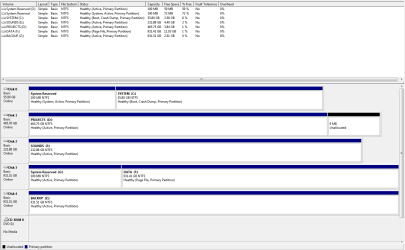

Thanks AddRAM, here's an updated screenshot:
* To fix that unallocated 9MB do I extend the partition (drive D)?
* It seems it's definitely safe for me to delete the G drive now also?
* Finally, after using Diskpart to set the drives as inactive as suggested by Kaktussoft I restarted the computer. I then went to try again to remove the Windows and Users folder from the F drive but got the same message as the second screenshot in my OP. Am I doing something wrong or missing something?
Thanks again for any help guys!

Yes.
Yes.
Not sure. Who is Alpha/Red, the users on that install ?

* To fix that unallocated 9MB do I extend the partition (drive D)?=>yes do it
* It seems it's definitely safe for me to delete the G drive now also?=>yes do it

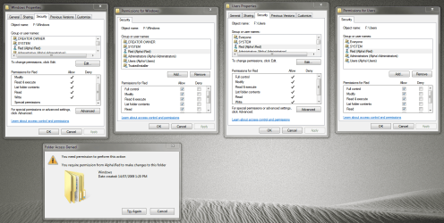

Are you logged on as user RED on computer ALPHA? Do you have administrator priviliges?
Yep. I'm sure that I have admin privileges, it's the only user account. Here's a screenshot if that helps:
Does system,admistrator,user etc have any DENY access in folder Windows?
No. Every 'group or username' seems to have full access with the exception of 'Special Permissions'. The only 'group or username' that doesn't have full access is the 'CREATOR OWNER' account and the 'TrustedInstaller' account that each only appear on the Windows folder permissions.
Here's the message I get when I try to delete Windows or Users from the F drive:

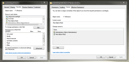

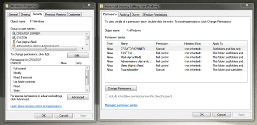

right click F:\windows , properties, tab security->advanced
Post screenshot
tab owner. Post screenshot as well

Thanks Kaktussoft, here we go:

In elevated command prompt:
[COLOR=red]become owner of everything under f:\windows[/COLOR]
takeown  /f  f:\windows  /r  /d  Y
[COLOR=red]reset the permissions. includes subfolders[/COLOR]
icacls  f:\windows\*  /reset  /t  /c  /l  /q
[COLOR=red]set permission to inherete. includes subfolders[/COLOR]
icacls  f:\windows\*  /inheritance:e  /t  /c  /l  /q
Works? any errors?
