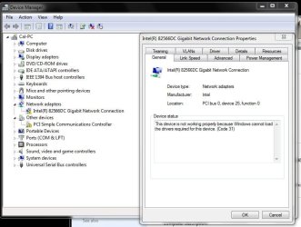

I have downloaded the driver from the link you sent me, but it seems not working,,

The LAN driver I posted is:
http://downloadcenter.intel.com/Detail_Desc.aspx?agr=Y&DwnldID=19058&lang=eng
File name:
PROWin32.exe
version:15.3
Date:05/14/2010
Status:
Latest Size:21.6 MB
Language:Multi languageOperating Systems:
Windows Vista 32*
My apologies.

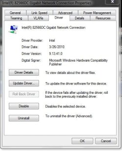

mike i have downloaded exactly the one you posted...but somehow after it installed , it just appeared version 9.13.41.0..

Sorry.
I downloaded the file and I can't access it without installing it myself which will mess up my PC.
I wanted to see what was inside the file.
Intel made a major screw up. They put the wrong files inside or named it wrong.
And that is the only LAN driver for that board at Intel.
Let me see in the Microsoft Master driver file list if they have the right one.
I apologize. :o Long day.
