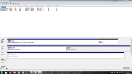

I have a PC, with 2 hard drives: Primary HDD, 250Mb, and a secondary drive, 1Tb.
The primary is labelled as 'C''Windows 7'. I have partitioned the secondary drive, into 2 drives: D and E. Called 'D' Windows XP and E my Games drive. D again is about 250Mb and E the rest.

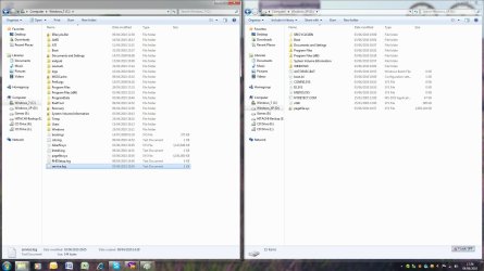

I then proceeded to install windows XP 64bit over my windows 7 64bit. Followed the tutorial here and it all went ok. I have the XP installed, operating fine and my 7 is also working fine. However, I can't get the dual boot display to work correctly at the moment. To boot into XP, I have to hit F12 during boot up and select my second hard drive to boot up. and if I want 7, it boots up by default.
I have modified my BCD registry per tutorial, both in XP and windows7. I get the dual boot message at the beginnig, but when I click on XP, it tells me boot.ini is not correct, failed to detect NTLDR.
Can someone please help me and tell me what to do.
One thing I have noticed is that when 7 loads up, the drives are as they are. But when XP loads up, it renames my C drive to D and my D drive to C. So even though 7 is installed on C drive, when loading XP, it says C is the XP drive! Wierd!
PLease see the attached screnshots. They are pretty much self explanatory, they where all taken with 7 loaded up and not XP.

The cleanest dual boot method with separate HD's is via BIOS boot order, or one-time Boot Menu key. This makes HD's independent to come and go as you please, whereas Windows-managed dual boot interlocks them.
If you want to use BIOS boot method, then just Remove XP from windows-managed Dual Boot using EasyBCD, set your preferred HD to boot first in BIOS boot order, then use one-time Boot Menu key to boot other drive.
If you still want Windows-managed Dual Boot, Install EasyBCD 2.0 beta to Win7 after doing quick registration to use beta in forum.
Remove XP listing on Add/Remove tab, then add it back, accept boot files, autoconfigures, Save, Restart.
Let us know how it goes.

Hi Nariman,
You see ntldr, boot.ini and ntdetect.com on the XP partition - just copy and paste all 3 onto your windows 7 partition.
Change easybcd entry for XP to point at drive C.
Should take about 10 seconds.

Thanks Guys. EasyBCD beta worked a treat! I can now dual boot using the windows bootloader. Thanks for the help
