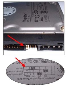

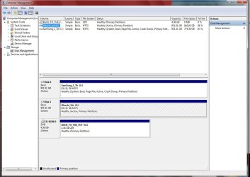

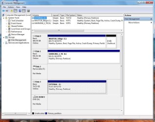

Does the HD show up in the Bios setup. How about in
:ar: computer Management :ar: Disk Management ?

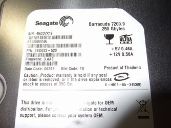

This is the harddrive. It shows that the slave option for the jumpers, is no pin at all. Just blank.
That is correct, I just checked the Seagate paper for that drive.
Just make sure that the Master drive is set to master and not Cable Select because then you have to bridge the 2nd pair of pins from the left.
