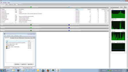

File 1 is the notebook 49% average usage for xtend

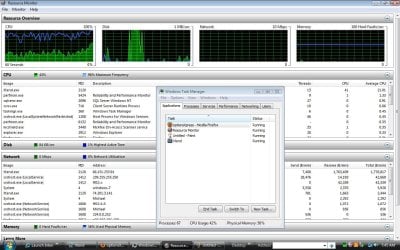

File 2 is the desktop showing 21% less than 1/2 of notebook within minutes of each other. jpeg file type.

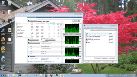

File 3 shows pieces of xtend not minimizing and remaining on screen until i opened another window.

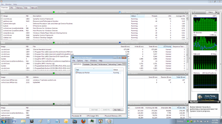

File 4 shows the graphics display of the xtend program
file 5 shows system at idle with only the resource monitor running and nortons system scan in background.
