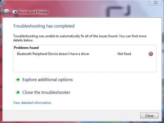

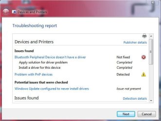

Hi Sandeep, I have downloaded all the necessary driver for my laptop from manufacturer's website. I also scanned my laptop for any missing device driver with hp diagnostics tool.Still I cannot connect my pc with any bluetooth enabled phones properly. An yellow exclamation mark occurs with my device image on laptop screen. After troubleshooting the device, message occures that there is no bluetooth peripheral device driver installed in my pc. I have given some screenshots here for assistance.

Hi Amrik Mondal,
Thanks for your reply. Please post a screenshot for the device manager of your system:
Let us know the model number of your system and Bluetooth card installed on the system.

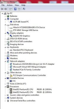

Hi Sandeep, I have uploaded here the screenshot of my pc's device manager window. Here you will find that there is no simple communication controller driver (PCI) installed in my laptop. But once I had installed it in my pc which could not solve my problem. Waiting for your suggestion.:(

Hi Amrik Mondal,
Thanks for providing this information. Please check this link below which might be compatible bluetooth driver for your system:
Broadcom 2070 Bluetooth Software and Driver - Compaq Presario CQ42-355TU Notebook PC | HP® Support
Please install it and let us know if it helps in resolving this issue. Also, let us know did bluetooth worked on your system earlier.
