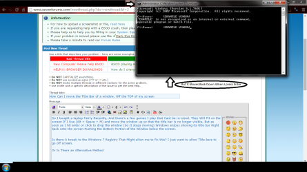

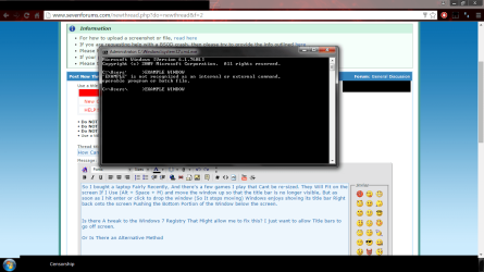

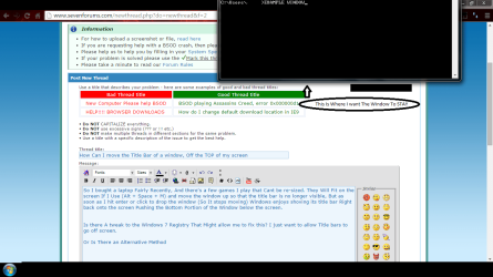

Pictures of what im trying to do:
(Changed To Links/Attachments)
Example Window Is the CMD Window
Moved The Window Offscreen Using (Alt+Space+M) And then the Arrow Keys to get it where I wanted it
Hit Enter and The Window moved itself back down even though I clearly moved it half off the screen
Changed It so the Images were attached and thanks. Hopefully I did it correctly?

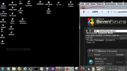

All I do is drag it off screen half or more. Left tick and hold some where in the area of the red line and drag. See if that is what you are look for.
Here is a picture.
Problem Is, Its not the Horizontal Screen Size that's the issue Its the Vertical. (Try grabbing that window and Bring it UP so it goes off the screen, Windows will keep pushing it down). Thanks though =).
