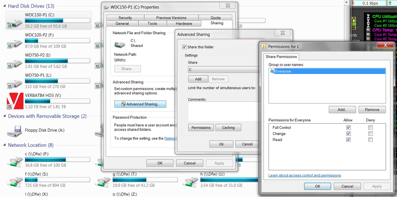

Then, to enable file sharing on each PC, open Explorer or My Computer and one at a time right-click on each of your drive letters. Select "share with" from the context menu to get the Properties dialog. Then push the "advanced sharing" button, push the "permissions" button, and check "full control".
Then OK all the way back through the set of dialog windows, and you should now have that drive accessible from the other machine.

Once the login is processed, you'll then see all of the shared drives on that other remote machine. You can then right-click on each of those remote drives, and select "map network drive" from the popup menu. Again, I suggest P for the remote C, Q for the remote D, etc..
OK your way back, and you now have the drives of the remote PC available as drive letters on your local PC.
