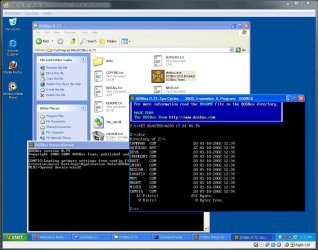

I just tested DOSBox inside VMLite, the following is the screenshot. I am not familar with DOSBox, but seems to be runing ok. It's installed on host, then invoked from VMLite XP Mode vm, H:\c\program files\DOSBox-0.73
Also not sure whether it's due to 0.73 vs your version.

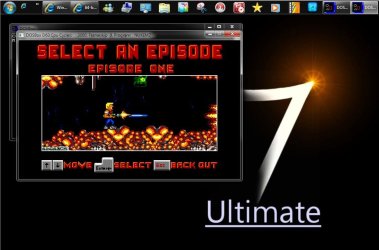

You'll notice the default "Z" drive seen at the dos like prompt there. In DBox you first enter "Mount C: C:\program folder" for whatever old dos app and press enter to watch C mounted in a virtual dos environment there. From there you type C: and press enter to change to C on DB and simply type the name of the executable to watch!
Here's one example of how a real old 8bit dos game one of first 1st person shooter games looks on DB being run on the 64bit 7 and even now you hear that through 5.1 surround over a board beep speaker on an old I386 museum piece!

will test more, but the first screens of DOSBox running are different in VMLite and Microsoft XP Mode, so VMLite seems to go a few more steps.
