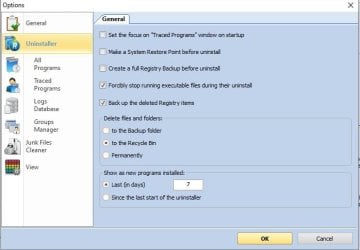

As was already mentioned about registry cleaners, I'll further add that they are in large part snakeoil. I wouldn't even mess with a registry optimizer. Even though products like Ccleaner, etc offer a registry cleaner, stay far, far away from using it. It can have the ability of messing your system up or software installations. For certain keys that need to be removed it's better to use a scalpel rather then a sword to get rid of problematic keys. It may be due to malware or in your case not using the uninstaller for a game or program.
Also note that using RevoUninstaller isn't full prof either. If you use it, make sure RevoUninstaller creates a system restore point first. Then when it comes to the deletion of registry keys look at each one very carefully and make sure it is IN FACT related to the software you are uninstalling. Don't say I didn't warn you.
Default settings Revo creates a restore point!
Also set registry backup as well!
I prefer a full disk image!
